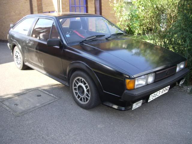

Originally the car was a standard '85 GTX champagne coloured tho when i picked the car up it had been painted black (badly!) Managed to pick it up for the pricey sum of £200 which included nearly a full years tax and test plus the past 10 years worth of service history - pretty hard to say no to really!
As it looked the day i picked it up (August '05)
The paint was bad, brush strokes up and down the 'C' posts and on the tailgate, originally i tried spraying over the black but it was pointless - the black would have to come off! Tried rubbing it down but whatever the paint was kept clogging wet/dry paper even when it was wet so as a last resort (and discovered by accident!) we managed to scrape the paint off with sharp chisels :!:
Strangely enough underneath the black stuff we found the panels to be perfect and you could still see your face in them :scratch:

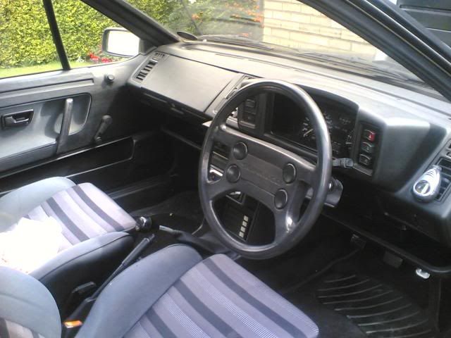

With the paintwork well and truly underway i had decided to fit remote central locking (had it on my old car and i got lazy using it all the time :chortle: ) To make it easier to wire up i took the dash out and was faced with a hell of a mess - i hate wiring :ire:
Before
After
Much better!
While i was at it i also managed to find an early electric window kit, very easy to fit but had to put the switches in the lower console instead of the doors
I like being lazy :yahoo:
