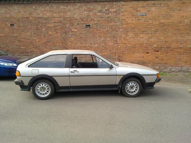

Outside the garage
All loaded up and ready to go
20 mins later it was sat happily at its new home

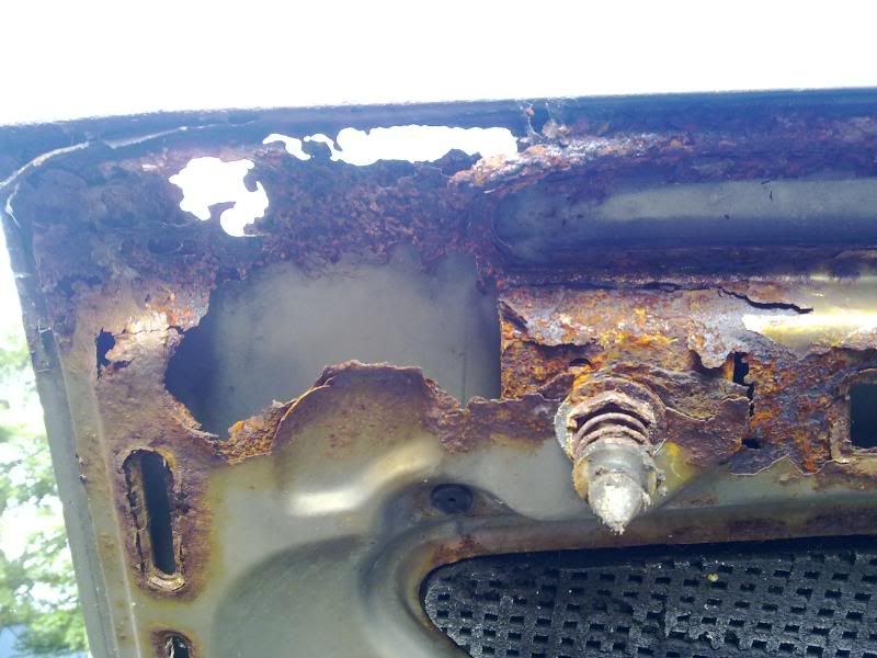

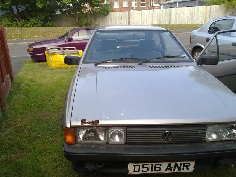

Yep, that is a hole in the bonnet
Luckily the chap i got the car from had already given me a spare one! In red tho so it'll have to be resprayed
