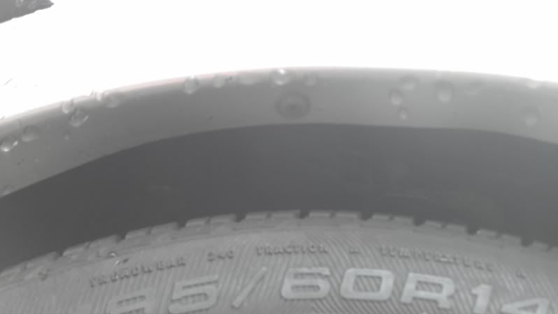

One more question guys... I've just been taking a look at my rear arches and I can't even see them for the bodykit, and if I roll them there'll be nowhere for the bodykit screws in the arch to go obviously.. soooo I'm assuming I need to remove the bodykit arch then fettle the body arch then trim the lip away in the plastic arch section of the bodykit?
Will the arch section of the bodykit still be secure with the screws no longer holding it on in the arch?

What happens is that the body kit gets heated and folded round the metal arch then that itself gets folded again. Done properly it creates a well sealed fold. Cover the whole thing with sealant and you're fit to funk.
Make sure you do it properly, screw up the fold and water will get in and rust the metal and the body kit will flap about like a mental cat.

I see, sounds like a specialist job this. Are the screws inside the arch actually holding the bodykit on or are they stuck on some other way, ie if I take the screws out will the arch fall away?Mr Funk wrote:What happens is that the body kit gets heated and folded round the metal arch then that itself gets folded again. Done properly it creates a well sealed fold. Cover the whole thing with sealant and you're fit to funk.

Euro - I got mine done at by a bodywork specialist and I know Sean (gxtra) got is done at The Phirm. I had my old ones done there and it was a very reasonable £45 a corner (only needed the rears doing as without the poo shields you get a lot of extra room).
You could do it yourself with a heat gun, an arch roller and a whole load of patience but frankly I quickly realised what the limits of my skills were.

Re: Slamming mk2 Scirocco and going wide... wheel size quest
How exactly are the arch mouldings held on? I can see there are screws inside the arch but are they also secured in any other way?

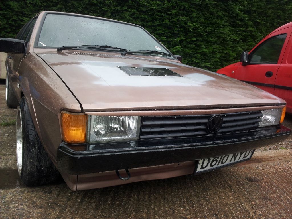

I've not started fitting any parts yet, I'm waiting until I'm off work in a few weeks but this is a pic of the car as she stands today...
